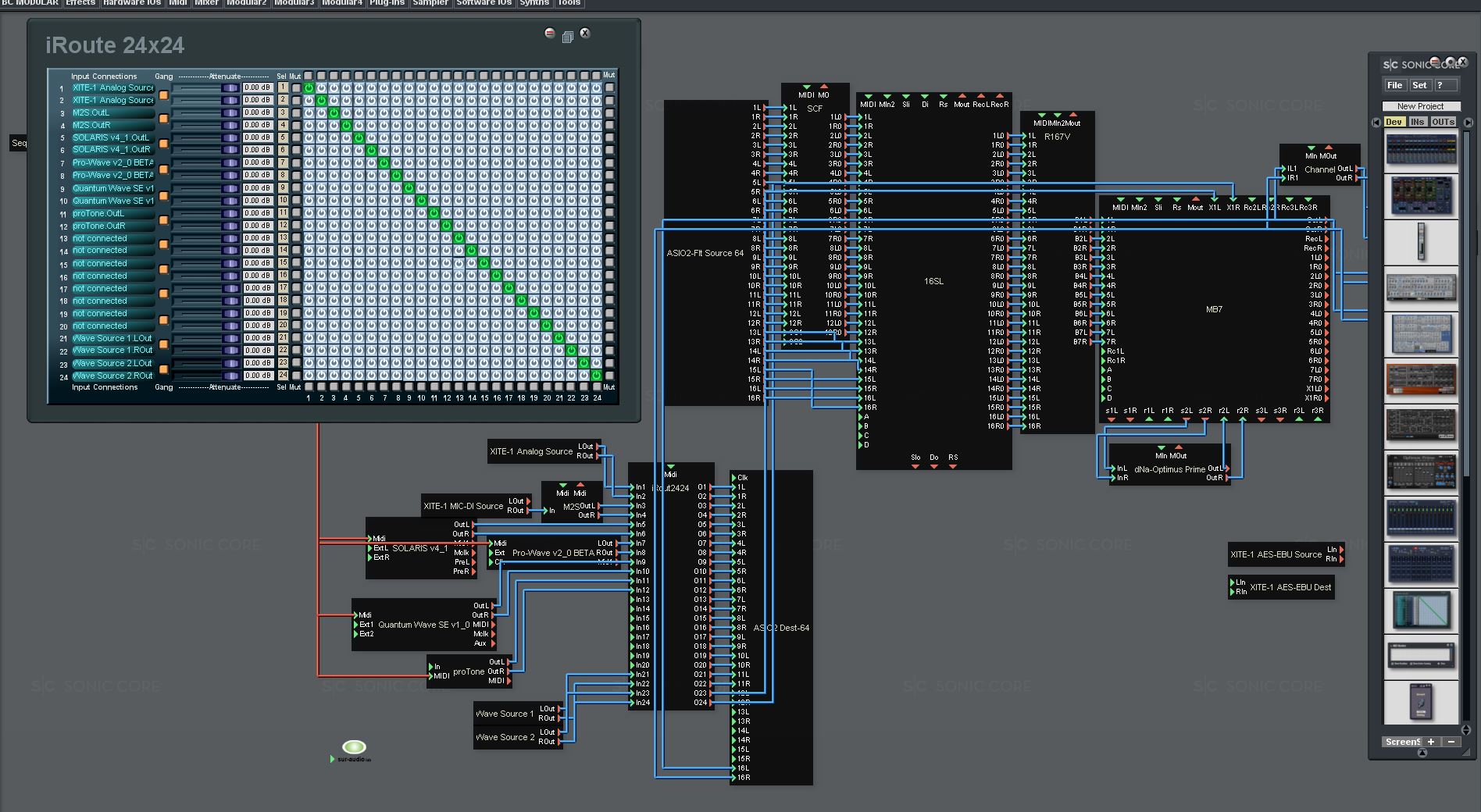

Great to see you're still working on the Modular Mixers Mehdi! I still use them in every project.
spacef wrote:>>>>>>>>>>@spacef.
I'm slightly confused I see mb4 and modular mixers on the sc download ftp. But don't see either of those mixers mentioned on the site or for sale?
Sorry I just saw that message .
The modular mixer v2 will be available soon on S|C webshop.
The basic pack is done, I am finishing a few router variations.
Then the pdf manual. and a bit of beta-testing of course.
May be it is better to wait another 2 or 3 weeks ?
BAck to SDK, see you in a little while.
