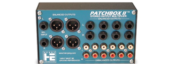

Re: Analog inputs
I get plenty of juice using XITE-1 mic pres on Hardware synths.
But even the XLR Ins run my SE-02/D-05s with plenty of headroom.
I also use Radial Space Heaters, DIs and a Henry Engineering Patchbox II which is a high quality multiplier.
