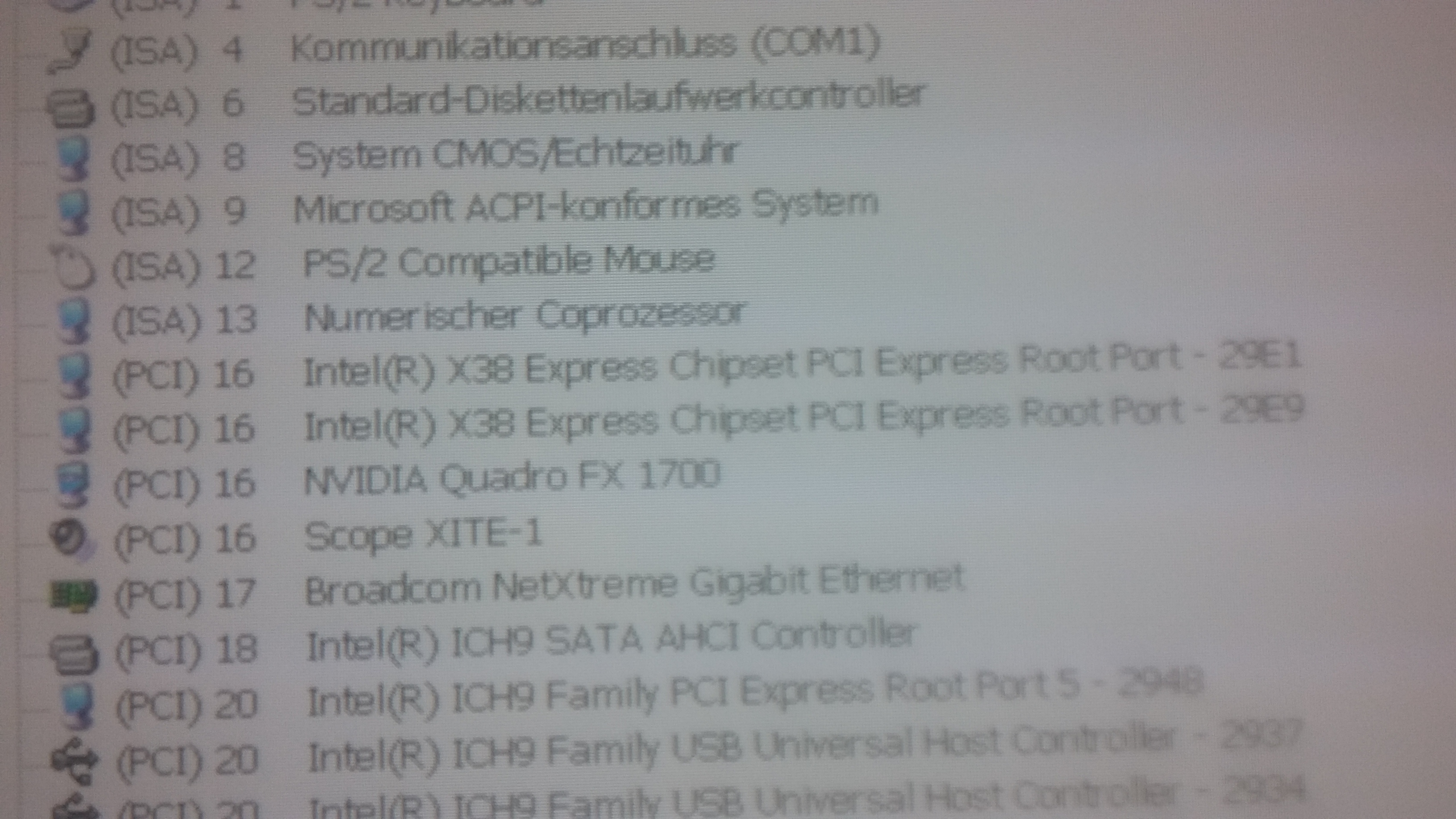

Yes, this would be my next purchase...but...I see conflicts with IRQ sharing...might this cause the problem? It ocurs randomly...the rate to get it started is appromaximately 25 %. Running xp sp3 on hp xw4600
Re: Xite-1 communication error/ hardware caonnot be setup properly
probably not what made the problem, but you might tray a different slot anyway. the PCIe root port controllers don't matter, but it's probably better if the video card doesn't share an irq with the XITE.

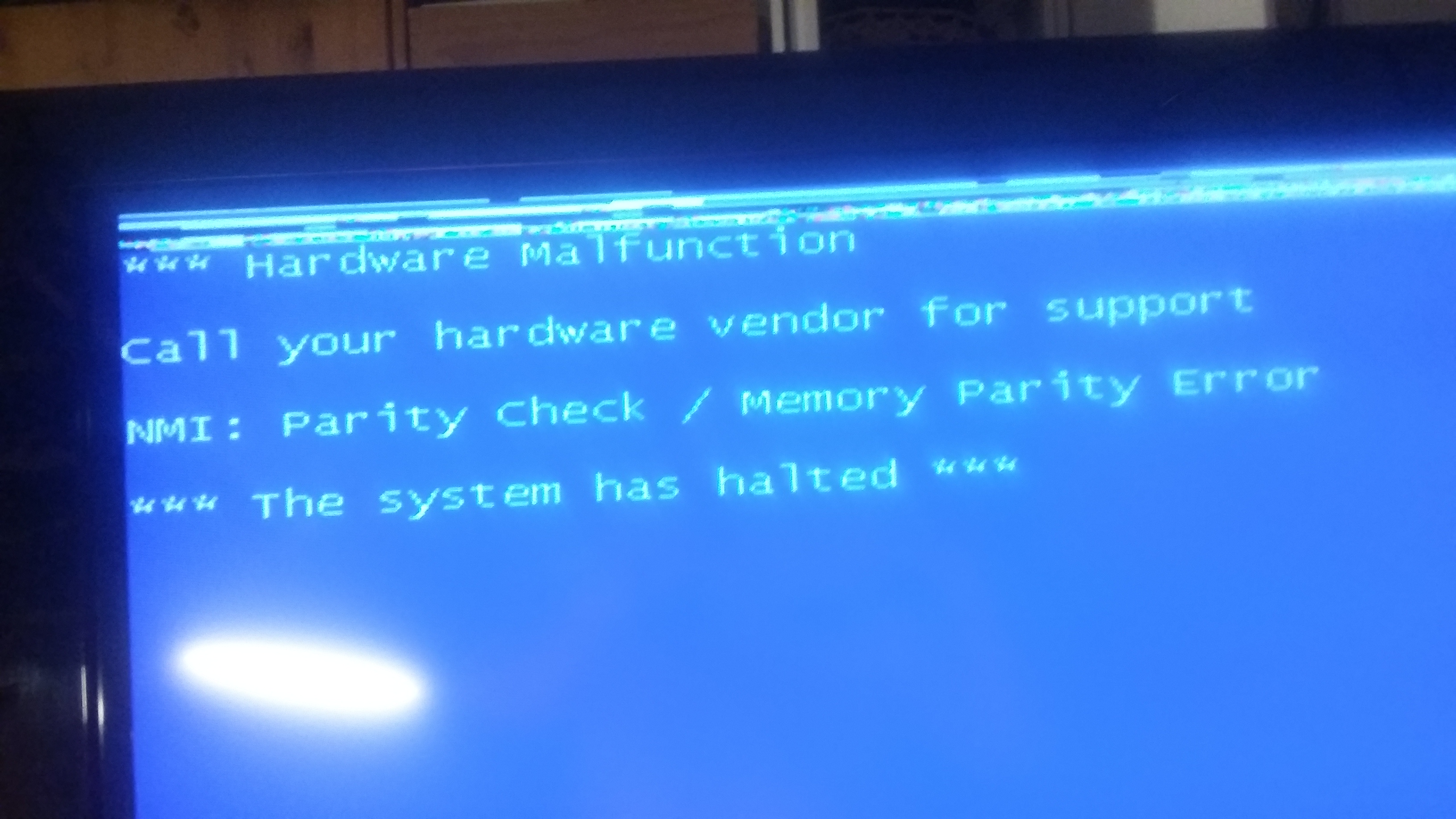

I have tried the card in every pcie port...all of them are at irq 16, sharing the grafic card. I had bluescreens. Now its set in the short pcie and it seams to function.
- bluescreen.jpg (1.44 MiB) Viewed 10741 times
