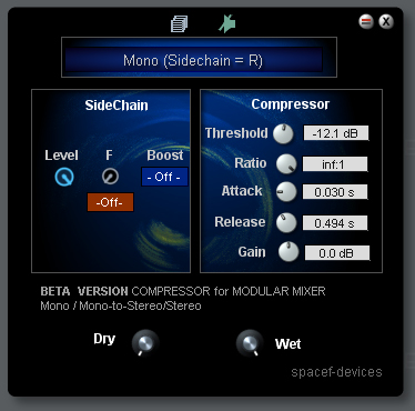

I think that routing field could have been abandonned because it doesn't save in presets or projects ?
Anyway,
Sorry to invade this thread.
@LiquidEdge
--> https://spacef-devices.com/DOWNLOADS/Mo ... ressor.zip
I did it after reading the thread, as I thought it might be helpful?
It is a plain compressor with sidechain that can be from ModMixer modulation inputs.
Also has different stereo modes with sidechain stereo or mono.
The "Mono" Mode outputs on L/R channels, so it is mono to stereo but doesn't do any stereo special effect.

WE LOVE YOUspacef wrote: Mon Nov 19, 2018 5:55 pm I did it after reading the thread, as I thought it might be helpful?
Re: Side Chain Routing Field

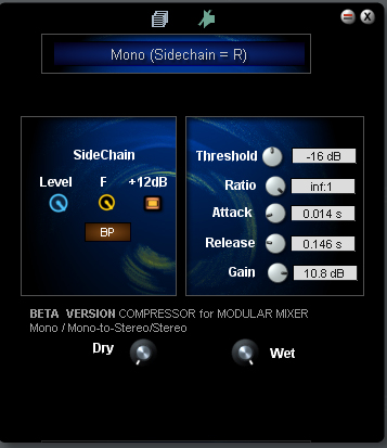

here is slightly better one
- Added sidechain gain booster +12/18/24 dB (probably necessary when a filter is used on the sidechain, 12dB did not seem enough to me).
- output gain was at +10dB which was too loud. now 0dB.
https://spacef-devices.com/DOWNLOADS/Mo ... orBETA.zip
Enjoy !
It works well with scope modulators too (lfo, sequencers etc).
Thanks again. Yes the gain is a very useful addition.
Just been trying it out but I am a bit confused about how best to set this in Modular Mixer 2.
As an example of where I am getting confused, let's use the M4 module from Modular Mixer v2 and take the most basic example of a mono kick track coming in on Modular Mixer v2 channel 1 and a mono bass track on Mixer channel 2. I just cant seem to figure out where to put the ModMixCompressor. I have tried inserting ModMixCompressor in both channels insert slots and also tried all the different routing options from the Mod Mixer selection but can't seem to understand the correct way to set this up. Sorry if I am being thicjk here, maybe a bit tired and can't see the wood for the trees. But if you havw a spare moment to post up a few examples with some pics I would really aprreciate it. Cheers.
I just tried, and I did struggle a bit and found the answer. There is a little bug but it works
Answer -- > http://forums.scopeusers.com/viewtopic. ... 30#p337630
Will try to make a video as soon as my phone is charged, and a correction of the device.
I will continue support on the other thread, because it is way off topic in this one
Thanks for the report !!!
