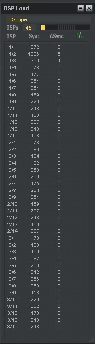

Ok, I just took some printout of the DSP load.
First, routing window empty, no modules loaded at all.

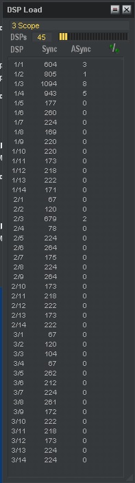

Next, just loaded up Python Pro, by default set to 1 voice
DSP load Python Pro 1 voice.jpg (38.22 KiB) Viewed 17992 times

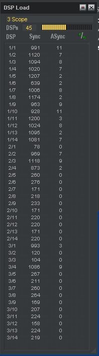

Then I changed number of voices to 10
DSP load Python Pro 10 voices.jpg (37.39 KiB) Viewed 17992 times
This doesnt look too bad at all

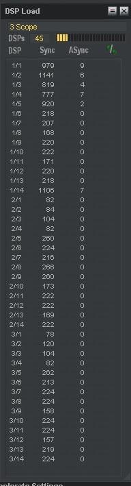

Just to compare this against Solaris v5
Solaris loaded into empty routing window. By default Solaris loads with 2 voices
DSP load Solaris 2 voices.jpg (36.84 KiB) Viewed 17991 times

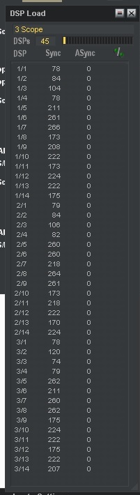

And finally, Solaris with 10 voices
Took about 15-20 seconds to adjust dsp load
DSP load Solaris 10 voices.jpg (39.13 KiB) Viewed 17991 times
So you can see, there is quite a big difference in usage between the Python Pro and Solaris, and comparatively, I think Python Pro is quite light on DSP load
N.B. Tested on on Scope 7 PCI 64 bit , with 3 x Scope Pro cards
