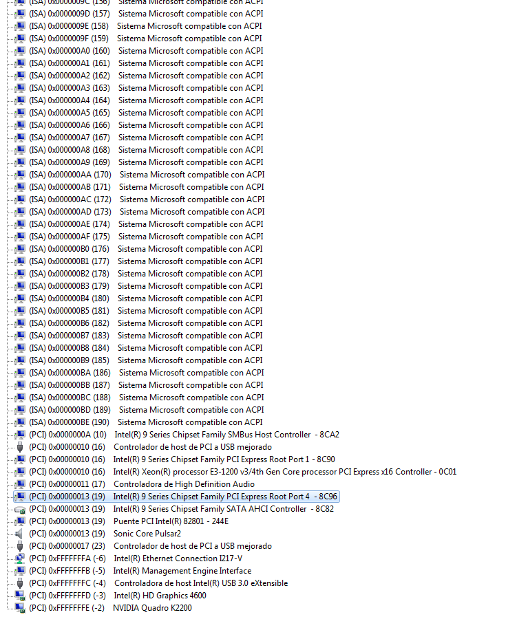

How does it look?
- IRQs.png (128.45 KiB) Viewed 6873 times
Re: Configuration problems in Win 7 SC 7
that should be ok.
system information is easier to read...(how to get there is in the link).
most importantly, is EIST and Hyperthreading turned off?
