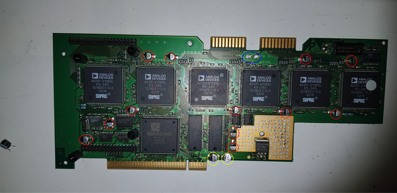

Capacitators marked with red is 47uF 6.3v
The two caps marked yellow are 47uf 16v
The blue mark is cleaned solder pads without a 47uF 6.3v.
I have ordred parts from Elfa, and i have to double check if the dimension is correct.
I can upload a video of how i recap the board next week :)
The I/O plate also ned recap, but i will check that later.
