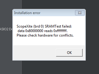

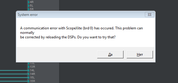

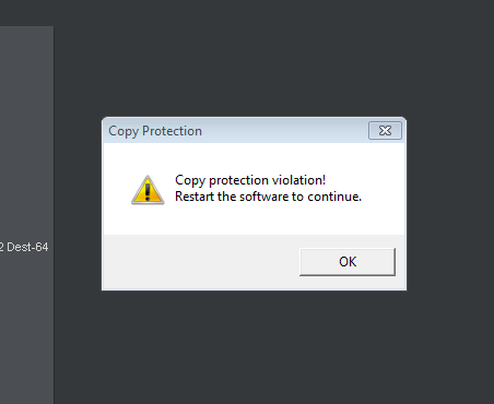

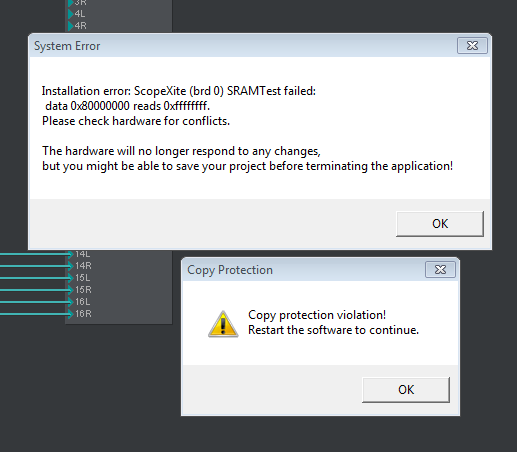

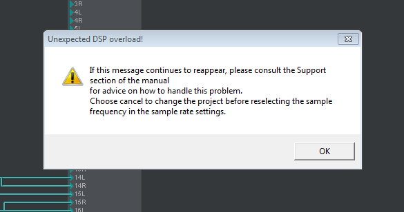

I don’t know if it makes sense to write in support, I’ll just leave it here. Loading any project causes a series of error messages.
If you are lucky, the scope starts working after the fifth or sixth restart of the computer, but sometimes the same can happen at any time.
XITE-1 scope v7.0.1706, windows 7

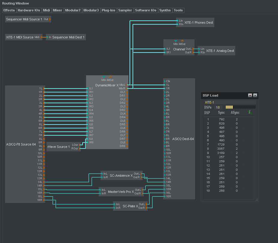

more

Looks like a connect fail between the pc and XITE - Try this first:
1. Take out the cable in both ends and reseat the cable. If this doesn't work, try another cable.
2. If the above doesn't help, try to reseat the pci-card in the pc.
If none of the above works, write here again :)

No, cable and card manipulations don't help. - The start up project works well, errors occur if I load another project.

the project is nothing big and third-party plugins. as soon as i launch reaper the errors begin
