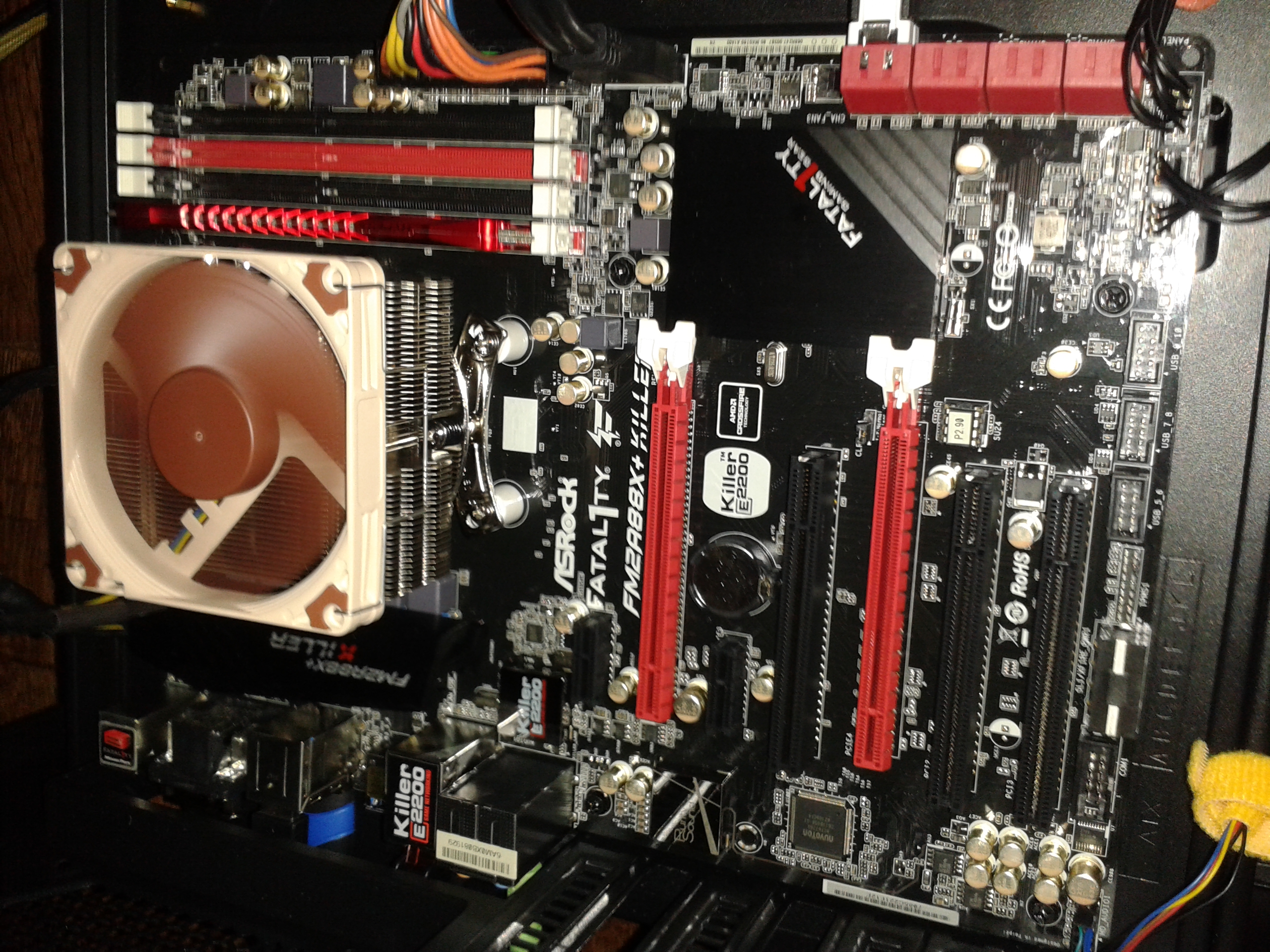

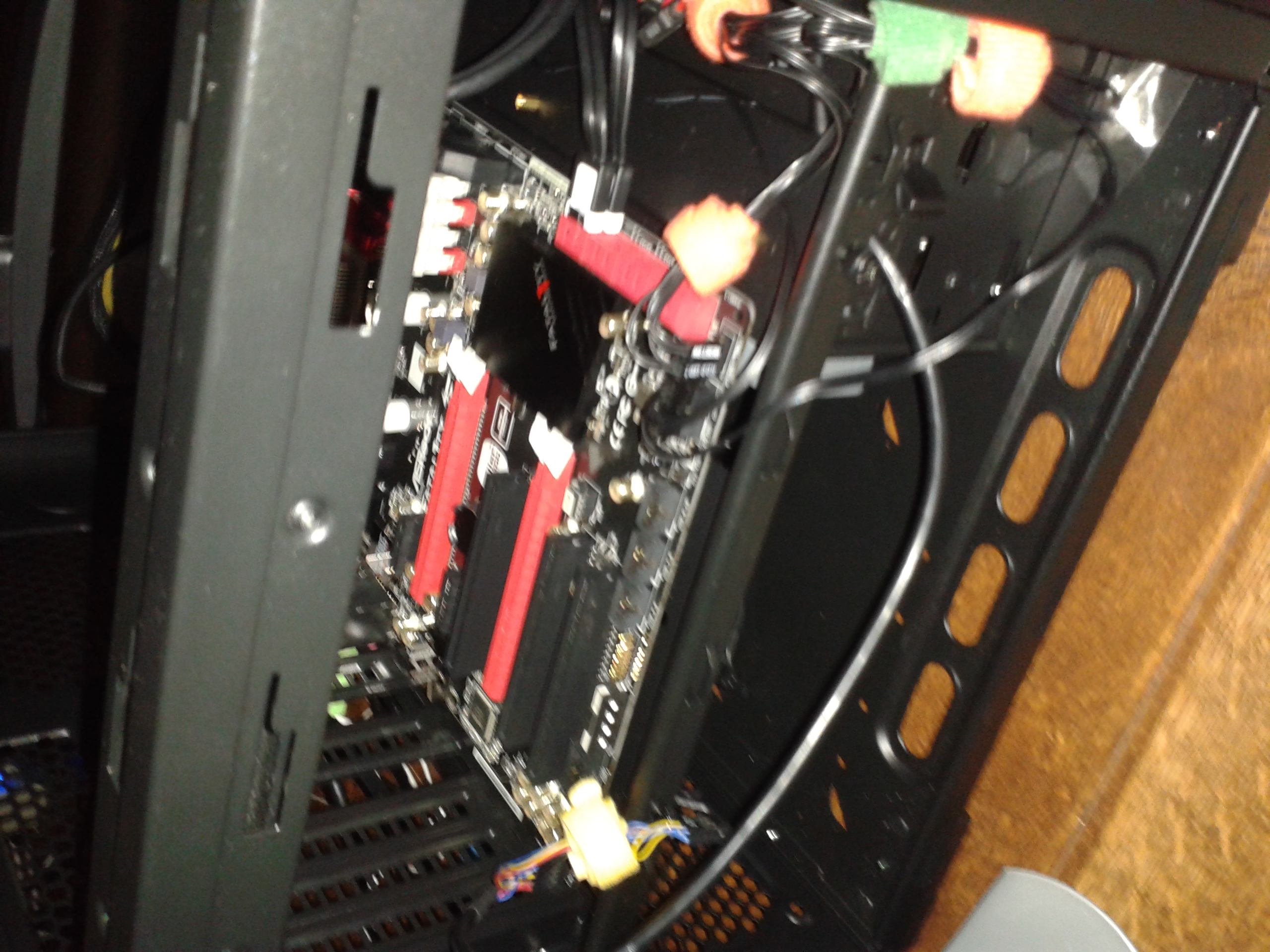

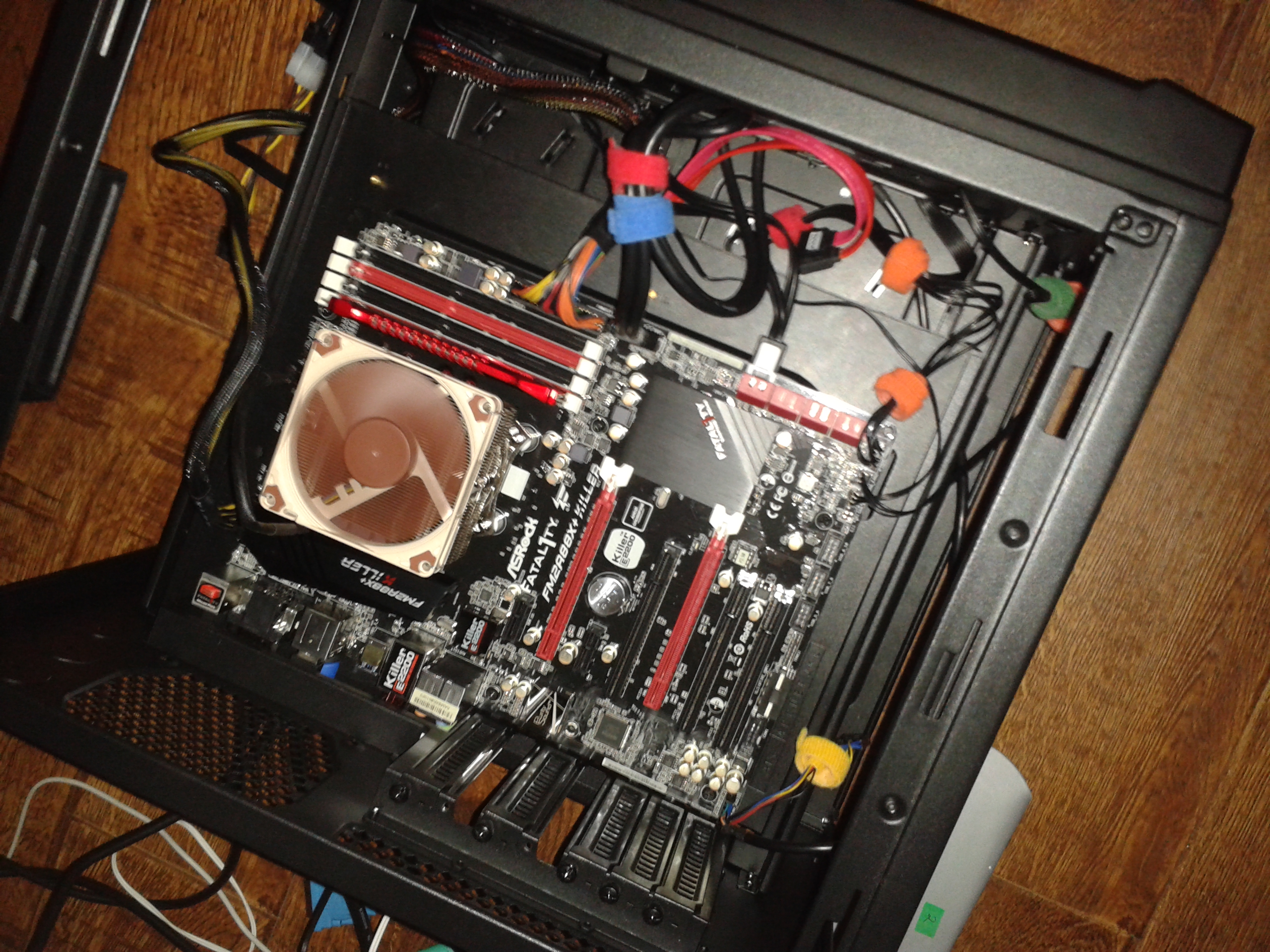

With a case like this
http://www.coolermaster.com/case/lan-box/haf-xb/
The sides can be taken off as well as the TOP - like a convetible with the windows down !!! - sorry for that !!!
but it's good for setting something up - and making changes more quickly to install OS and drivers ----
fraz
Posts: 1009
Location: Springfield !
Re: Z170 build with 7700 K
Post by fraz »
Just 3 pics of said computer case / test bench - very handy - this is getting quite a bit of use --

The one in the picture is AMD FM2+ - Dante was aking how many cores were in the Z170 / H170 build for the 7700 K - With so many CPU's it's difficult to just know how many cores there are.
The picture is FM2+ AMD - 7870 K APU (graphics AMD Radeon R7 included) - AMD varaiant of HD Intel ! - It's a 4 core CPU
https://www.cpubenchmark.net/cpu.php?cp ... 0K&id=2531
So not that powerful - like an i3 really - but how good it is for real time audio - only time will tell - but AMD isn't as good as Intel from reports of other users.
Yes it is a nice build that why I bought it for the Scope PCI cards that have been collected
Oh Garyb by the way - I've done a Windows 10 build x64 for one of these boards as well and did some copy/paste of files and the USB 3.0 connection dropped out on the USB-SATA bridge drive - So from the PM I sent you the other day - It's safe to say it's a Windows 10 thing - this is a different board to the clone that went wrong -------
But anyway 1, 2 or 3 Scope cards would do quite well in this - Windows 7 32 - and if needed VEP for access to another PC on a network - with more RAM -
By comparison to other motherboards - this is low end budget - but is the top end of the AsRock FM2+ line so should be quite durable. The BIOS looked quite good as well for AsRock - Very similar to the Asus BIOS, not in look but the arrangement of the windows and navigation.
This is a test bench - so when this is done another one goes in !
