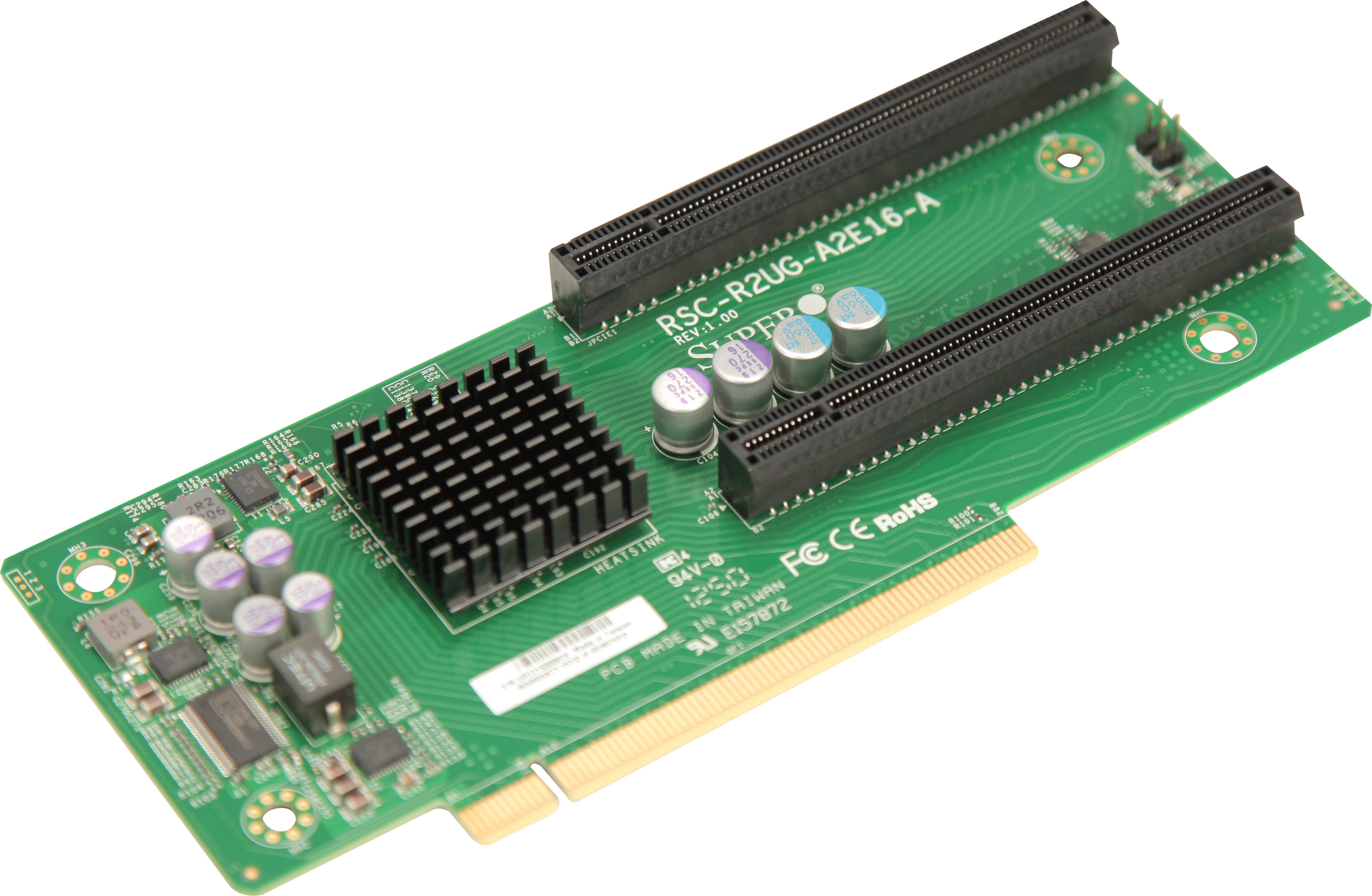

I found what I needed @ Supermicro.
Imagine that.

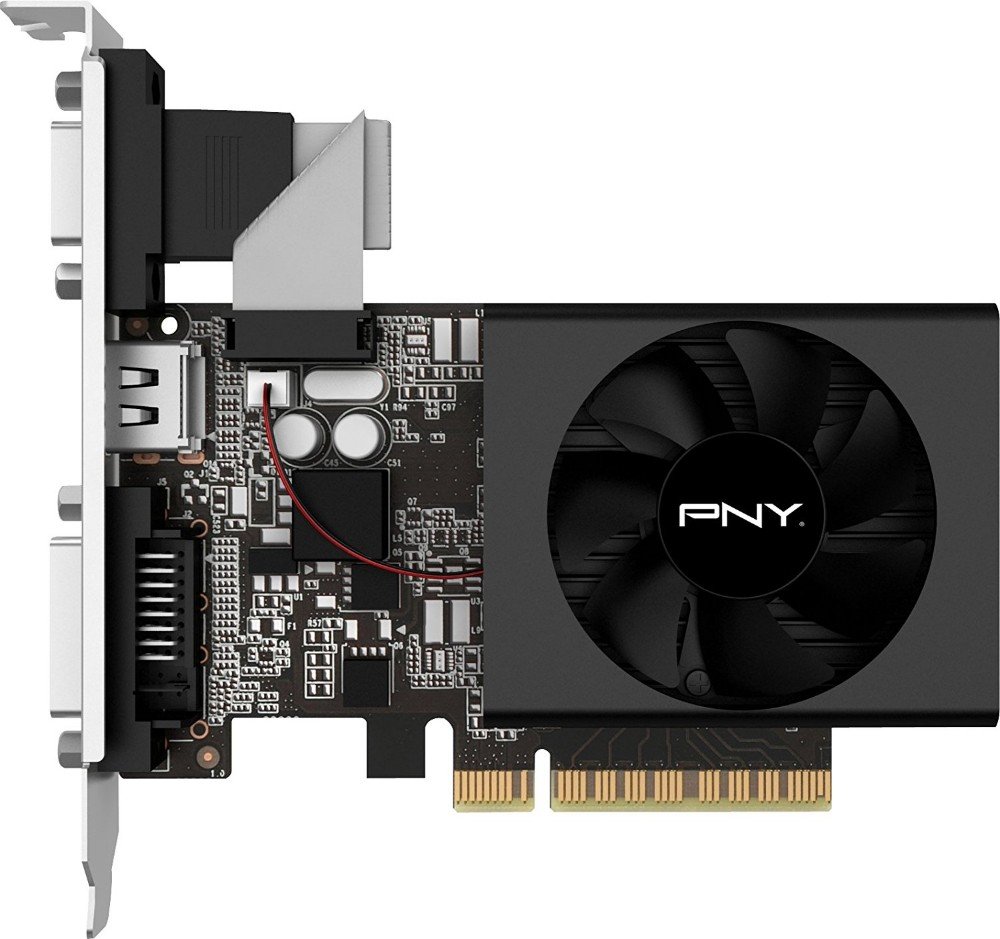

I need a cheap 8x GPU for 2D.
And a 1X for XITE-1 PCI-e.
I’m told the 16X on a Mini ITX has enough juice for an 8 + 1.

I like Supermicro :) Wasn't sure you were willing to pay ~$300 though. Also I believe that's a 2U...so you might need a 1 slot GPU...
Re: AMD Question
Posted: Wed Feb 26, 2020 2:44 pm
Actually a 2U for the Nanoxia 2U.
Money is never a concern as the investments pay themselves off quickly.
There’s also a 60 dollar version but not as robust as this device.

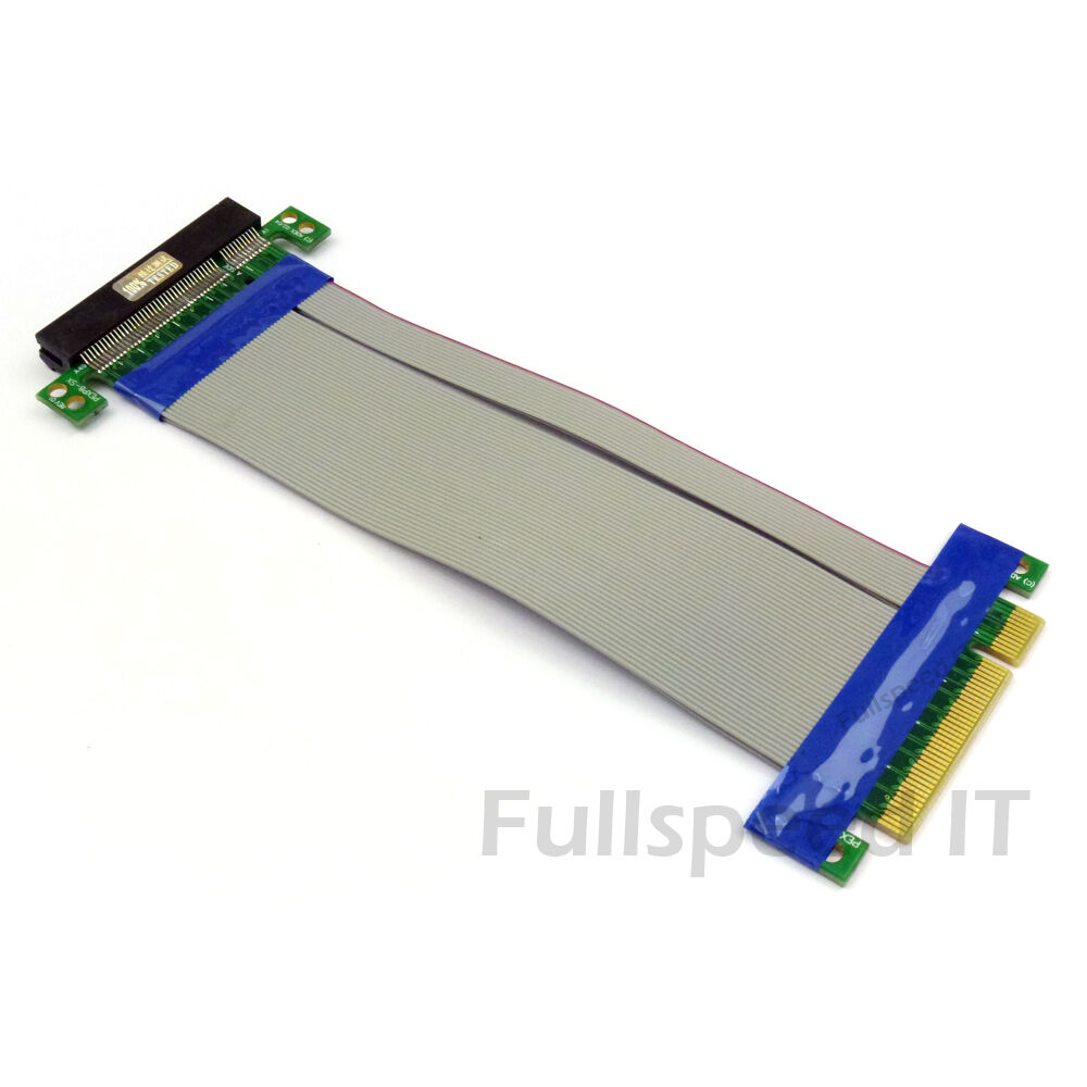

Here’s the GFX 8X Card and connector ribbon.
Just put XITE-1 PCI-e 1X on 2nd slot.
Re: AMD Question
Posted: Wed Feb 26, 2020 3:34 pm
Yea it was the clearance for the GPU i was concerned about, wasn't sure what size case you're using. The ribbon should solve that for sure. :)

Splitting up power on a riser card where a 16x renders an 8x and a 4X
PCI-e Bifurcation is what they call this.
Has to be mentioned in the manual that the BUOS will allow this.
Re: AMD Question
Posted: Mon Mar 09, 2020 4:07 pm
And that's where the bridge chip comes in on that riser card. Thanks for keeping us updated Jimmy :)
