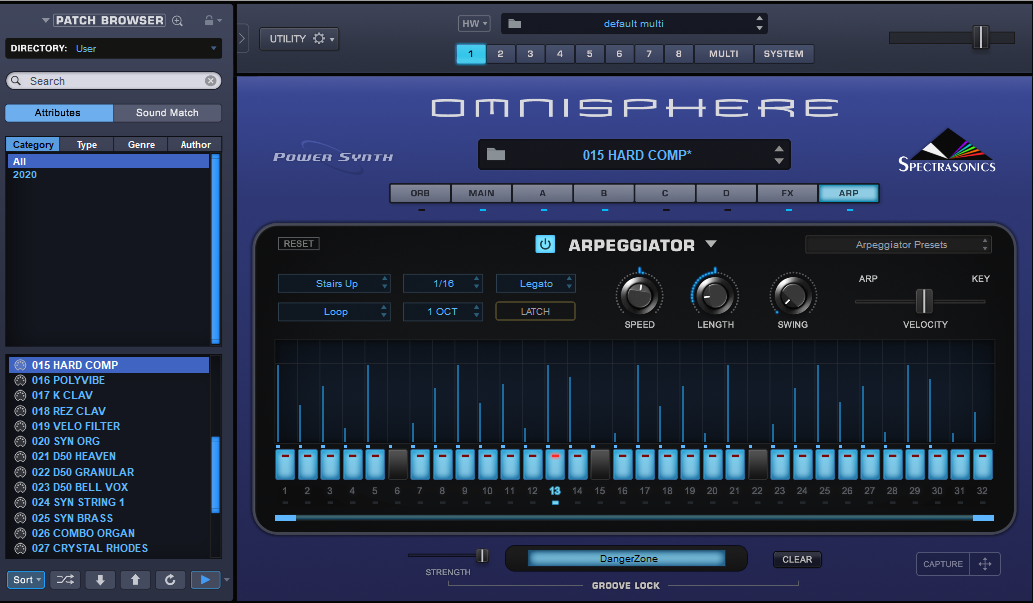

Here’s what I got after dragging the MIDI File into Omnisphere.
My issue is I’m not sure if the arp they’re using is written as a note on only or a pattern re triggered with a new note every 4 beats, etc.
Totally clueless.

doesn't look quite right as far as the intervals are concerned. maybe if it sounds right then use it?
Also in the DAW it's written as continuous notes so not sure if that translated correctly.
Can you record it and post?

I’m chatting with SynthGuRu and with his Omnisphere chops I think he can nail it.
Needs to have instructions on how to play it or just a 1 note trigger tying 2 x 32 step arpeggiators.
Whatever happens I will share it with you and we’ll see if it works.
The guy knows his hardware and software. After a quick listen he said it sounds like the Oberheim DSX and started trying to explain how the blank spots are where the pattern retriggers.

Re: Arpeggiator/Sequencer Expert Help Needed
Send me a paypal link, you get an a for effort.
It’s close but there is a pattern of stutters that breaks up the lick.
SynthGuRu says after he wrote it out from isolation and half speed tricks, and will put it into Omnispheres arpeggiator tomorrow.
I’ll share it as it should be a great exercise in reverse engineering.

Even his is slightly off but I guess I’m going to have to play it while sustaining the left hand chord.yayajohn wrote: Wed Mar 18, 2020 4:12 am Cool. Glad you got someone to sort it out for you. Will def want to hear it so thanks.
You can pay me in TP rolls since that is now the new currency![]()
Nah it was a fun exercise. I'm always trying to dissect stuff like that
Probably need both hands too.
