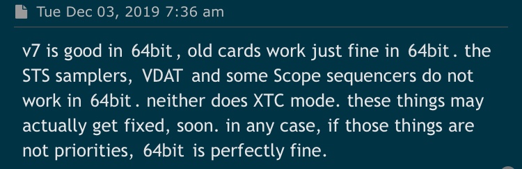

I do hope these things get fixed “soon”
- 0E4F5E22-A014-4539-B6B9-62140298C92A.jpeg (75.44 KiB) Viewed 4092 times

There is a VDAT64 for quite a while and the VRC doesn‘t crash anymore in Win64.
Liquid EDGE
- Posts: 1205
- Location: Brighton England
Re: Scope 64bit & 32bit essentially the same thing?
Great. Is that in the win 7 install or need to grab an updated file?
VDAT does not work currently, in 64bit.
