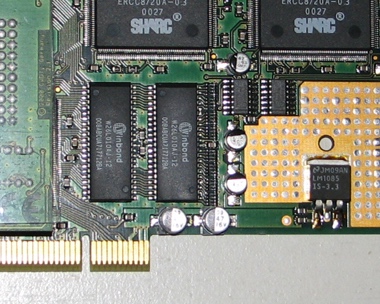

This message can be misleading, I remember it from a Pulsar One...
In the end (in my case) it were the buffer caps around the SRams, located at the bottom right end side of the PCI connector.
It’s about the 2 small silver tubes and if you only spot one or none at all, they may have come off accidently while placing the card into the slot.
There‘s another pair of such caps right beneath the SRams at the beginning of the empty area with the voltge reulator.
These caps are much easier to resolder than the old through hole things of the Pulsar One.

I need to source the 2 capacitors located at the bottom right end side of the PCI connector marked 3c 47 16v
Does anyone know where I can buy them ?
My card has the same error message and one of those 2 capacitors has corrosion on the side.

Pretty much, as long as it's 47 microfarad and you match the polarity. They're just acting as noise filters and/or dc decouplers here, so matching things exactly isn't so crucial.

Btw yesterday I got the very same SRAM Test failed message from my own Pulsar 2.
Visual inspection didn‘t show anything at all, not even with a good magnifier.
Reflowing the contacts of the 4 caps (shown in the pic earlier) with new solder solved the case.
(just watch out for the plastic bases of the caps to avoid a melting mess)
You don‘t always have to replace caps... there may be micro cracks underneath the SMD parts.
