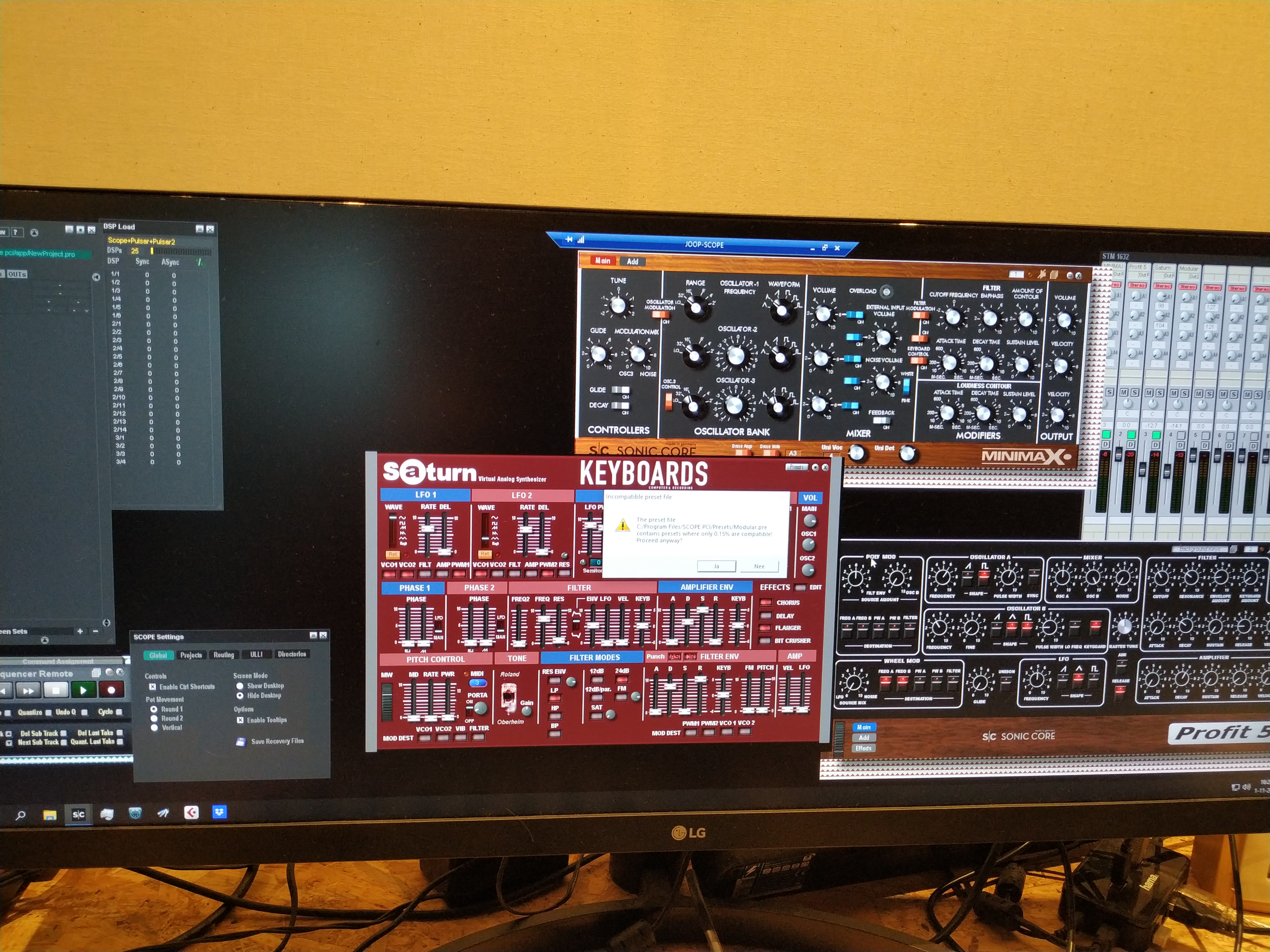

So I have minimax v7, saturn and profit5 loaded and in view. Also stm32 mixer.
Modular 4 is loaded in the background, as are Masterverb Pro and Das Tape Echo.
When the three synths are loaded, there's a dialog window from modular asking about the preset list. When I close that window, minimax disappears.
I have taken pictures, but | hesitate to upload them because they are quite big.

- 2021-11-01 16.20.48.jpg (2.11 MiB) Viewed 2419 times
- 2021-11-01 16.20.39.jpg (2.09 MiB) Viewed 2419 times
Re: windows appearing and disappearing
The second picture should be first, but you get the idea.
On loading all three synths show (second picture), then when I click OK in the dialog window, minimax disappears (first picture).
Of course, this is not the biggest problem in the world, but it makes me curious. Why does one synth disappear, and the others stay in sight?

I tried it on the machine (so no remote desktop) and the Minimax behaves the same.
