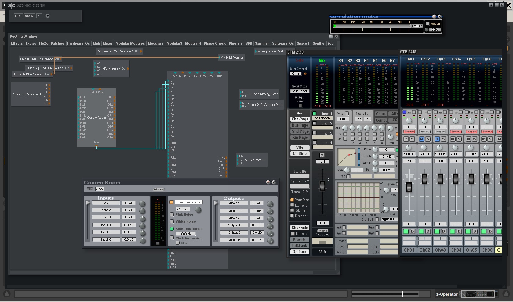

OK I'm a little confused. I think I may have asked this before but how does the Stereo channel behave relative to audio?
I sent a sine wave to both the Left and Right of the stereo channel and I phased one side expecting it to cancel out and it didn't? I the did it with 2 Mono channels and it cancelled out as expected.
Could someone explain the architecture of the stereo and mono channels, with regards to incoming audio and their phase options.
Thanks
Thanks

If you feed a stereo channel with a sine wave, the signs should cancel if one side is phase inverted. It doesn’t seem to happen in the STM mixer

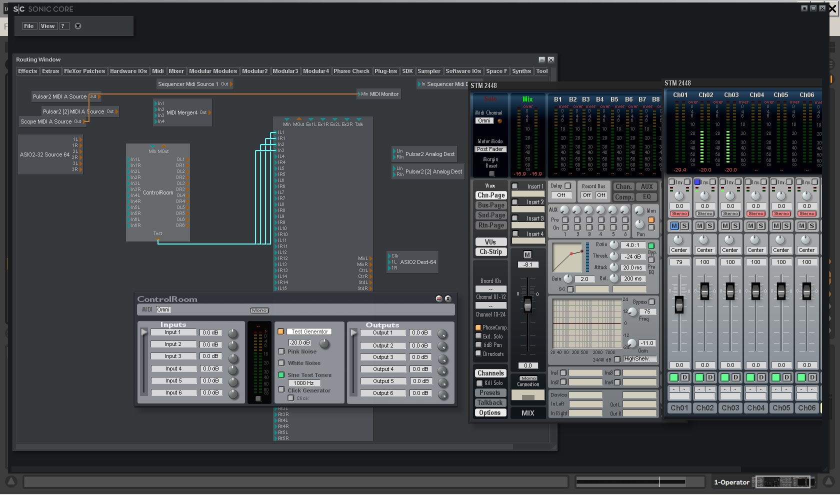

Hi guys
I've just tested a few things and it's not a phase problem. It's the architecture of how mixers are built. the Ableton mixer shows the same problem.
If you phase one side of a stereo channel. Scope mixers or DAW ones it shows that there is just a 180 degree correlation between Left and Right nut funnily no phase cancellation when sent to the master out unless you mono it.
I find this structure weird but am getting my head around out. Please look at my pics if I'm not making myself clear.
Thanks
Thanks
- stereo channel 1 phased side doesn't cancel against other.jpg (408.76 KiB) Viewed 5800 times
- mono channels 1 phased cancels.jpg (384.89 KiB) Viewed 5800 times

This is what I was saying, expecting a null to occur when the busses are not architected that way is a bad process, not a bad result.
