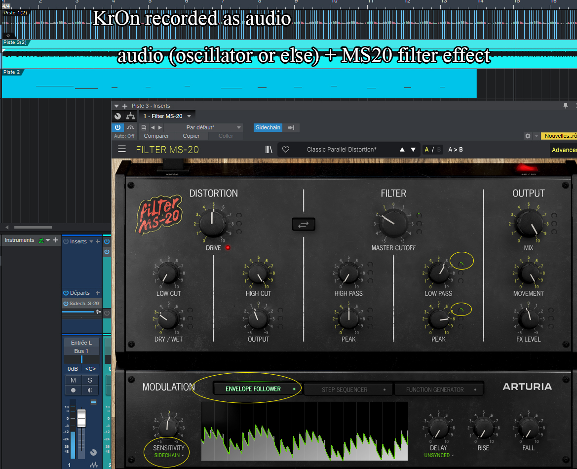

I just wanted to add that I just tried the MS20 filter from Arturia and it works fine with KrOn !
- record KrOn as audio in DAW (I did not try "live" but it should work the same).
-- send recorded audio to SIdechain of MS20 filter (and also send the modulations to a bus that does not go the mix, level at -inf or mute, ie, a bus that goes nowhere, used only to route modulators away from the main mix outputs).
--- In MS20 filter, select sidechain in the "envelope follower" section.
---- move the first "circle" near cutoff or resonance to add the required modulation amount.
so it means we can synchronize modulators in scope + DAW + eurorack at the same time with a single modulator.
The Filter MS20 from Arturia may still be free (after, it will be 99€). It's the only filter effect I know that has sidechain input for modulation of the filter... You can also modulate resonance, which is uncommon too in the VST world.
Grab it fast if you can and if it is still free !! it is pretty good filter.
In the pic below, I quantized KrOn because i did not pay attention and recorded it quickly and a bit out of time
Anyone knows other filter effects with sidechain inputs to modulate cutoff (and resonance) ? i think it is not common at all.
So, bravo Arturia !
extra tip: do not normalize or change the volume of the recorded KrOn modulation. keep channel fader at 0dB. it is better to use the modulation amounts of the effect ,it is easier to use (more useable range than the level fader). And don't forget to route it away from your main mix outputs.
