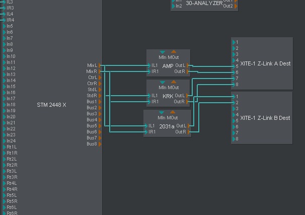

I have 3 pairs of speakers, attached to my A16u.
To feed them, I use the mix-output of my mastermixer connected to 3 "channel", so I can set the volume for each pair of speakers.
Although my projects are less then 25% of XITE resources, adding three channels often gives dsp communication limit messages. I have to manually assign to dsp to get rid of this.
The channel-element seems very primitive to me, so I wonder why it causes this messages.
(I could add a complete large mixer, without getting warnings)

It‘s probably due to the layer for external communication per device.
Each channel device needs it‘s own, while a mixer made of many channels only needs one.

Here's a picture of the section, which causes the trouble.
I can assign all 3 channel to DSP 7 , which makes it work.
But when doing so on bigger projects, I get errors on reloading, although the project worked at saving.
Is there an other device doing the same job ?
Is there a way to see, what DSP is used for the surrounding devices ?

You may try a Dynamic Mixer with that trio and use the direct outs to send to destination.
(in non Xite Scope the DSP load by single Channels was at least noticeably higher than all under 1 surface)
Channel got a lot of features: midi, invert and 2 inserts.

Wow ! I never realised that direct outs in dynamic mixer.
Works perfect !
