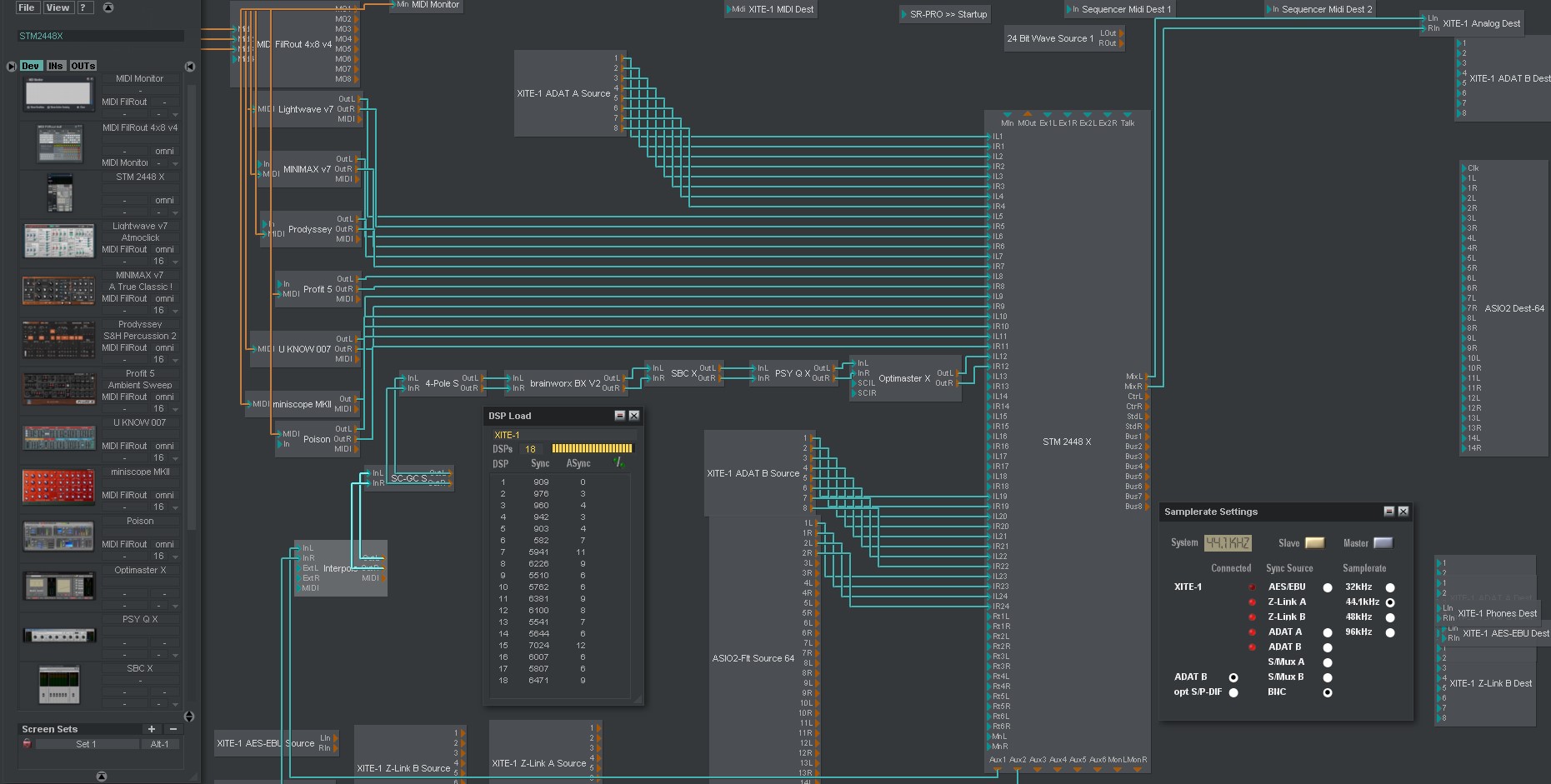

Not all the users own and use the sdk and I also have the impression DSP systems behave different in (PCI) and being connected (XITE) to different computers.
B.t.w.,- I wasn´t able rebuilding Yayajohn´s XITE-1 project where he maxed out polyphony up to 16 voices for every SCOPE stock synth.
In fact, I gave up after some time and accepted it doesn´t work w/ my XITE-1 which is using the older PCIe card (w/ DVI connector) in my 19" 4U rackmount DAW PC (Z97, Intel i7 4790K, 32BG RAM, SSDs, Win7 Pro SP1, SCOPE v7 x64).
With my system, I get SAT connection error messages soon and when I load about 4 or 5 synths and try to max out polyphony to 16 voices for each.
I made a PDF from his post and put it in the attachment,- just as a reminder what we´re talkin´ about.
Below a pic of his project.
- 3_Maxpolywitheffects.jpg (279.04 KiB) Viewed 16825 times
