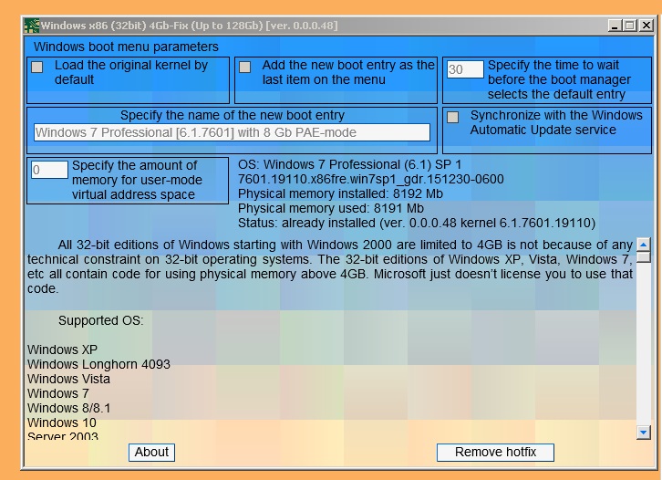

It seems to be possible to get 5.9 ms round trip latency at a buffer of 64 - attached is a JPEG of this - I was hoping it may be possible to up to 96 Khz (thus halving the RTL) but not if it halves the track count.
PAE patch has been enabled and it works - but it did not work on EMU 1212M (PCI) nor did it work on Focusrite Saffire Pro 26 (used_&_cheap)
PAE PATCH JPEG.jpg (149.94 KiB) Viewed 16618 times
