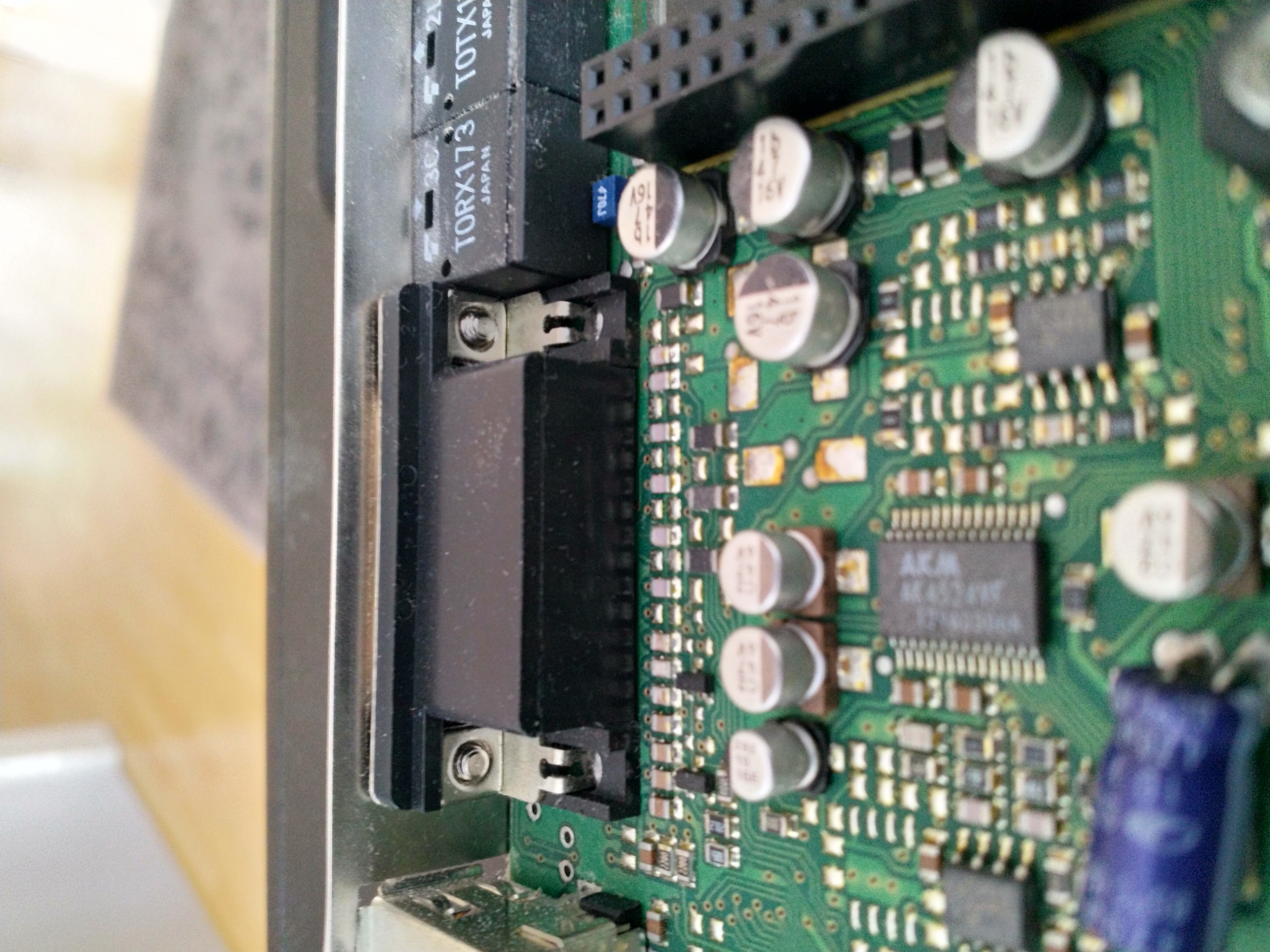

Hi, I have Win10 PC installed Pulsar II card with Z-Link and been using on many yers.
Now right Output Channel just stopped working?
Both chanels show meters on my daw (Adobe Audition) and scope software. Checked scope routing, swapped left and right out etc
Cable fully checked and correct. swapped left /right wiring, changed cables etc Analog amps, spkrs/phones checked?
Yours Matti

you checked the inside of the d-sub?

Hi,Unfortunately I can't find on the Pulsar interface board or interfaces
anything that would help solve the problem for me with reference to your answer. As an attachment I put a picture of the card (See Appendix Pulsar card.jpg)?
Has anyone else had a similar problem and could help?
-Yours Matt
Pulsar card.jpg (7.58 MiB) Viewed 13087 times

the d-sub on the cable whip as well as the connectors on the cable whip?

You can use a V/Ohm meter to test continuity on the cable whip.
