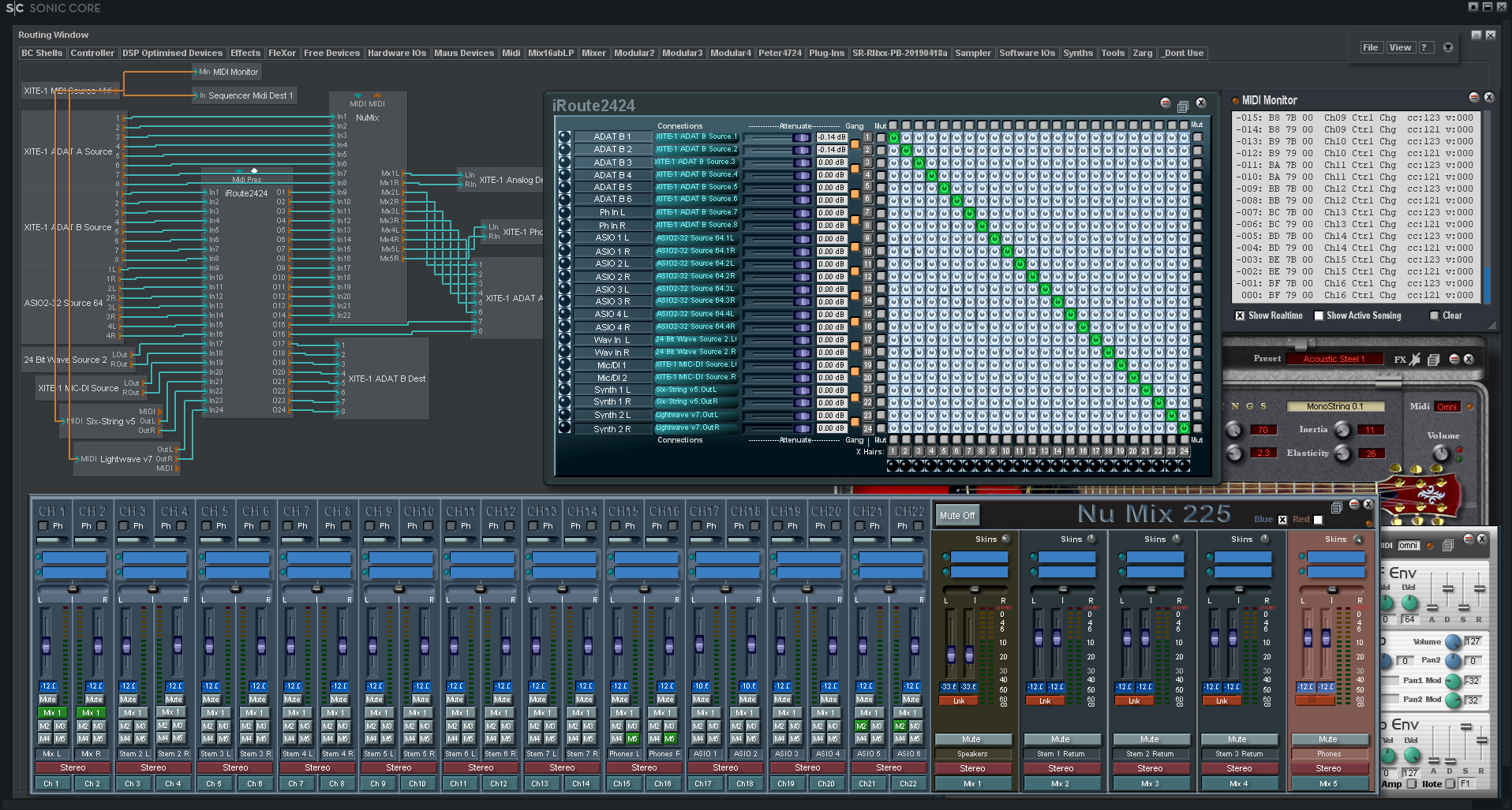

You can see in the pic below I have set the mixer to:
  • Inputs - 16 ADAT (from the RayDat mostly fort stemming), Wav Stereo in and Mic/DI ins,
  • Outputs - Speakers, 6 ADAT (Returns to RayDat for bouncing mixers) and a Stereo Phones out.
Also my SCOPE Project contains 8 * ASIO2 channels to ADAT B, which I have been using to send Kontakt 7 instruments to the RayDat (Could ASIO2 with SCOPE synths if required).
Not shown here, but I also have a A16 TDAT Analog interface that allows for 16 IOs to the outside world. So its all pretty flexible and more than meets my needs.

An update to the NuMix255 mixer.
Scratch fields not saving in presets, and Channles 1 & 2 were crossed up.
My new default project now includes the iRout2424 to allow flexibility in how and where channels are sent.
It includes:
- Indicators to show IO activities,
- Selectable Cross hairs to help locate channel switching,
- Mutes on all IO's
If anyone is interested in this device, I will upload this device (and its smaller cousin iRoute1616) in a separate post.
