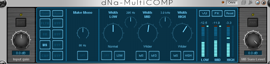

nebelfuerst
- Posts: 601
Re: Air to the sides ?
Just found out, that this function is part of dna-multicomp.
- Clipboard01.png (97.91 KiB) Viewed 21734 times
