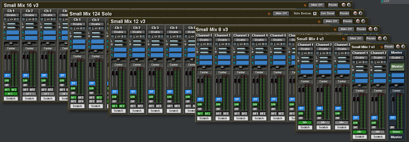

Hi There,
Updated (version 3) Small Mixer family.
Updates:
- Removed Drawers (Shublades) Open Drawers were not always displaying properly - now all controls are on the front panel,
- Optimised Range Text fields to better approximate actual dB levels, and
- Some minor optimisation of the panel.
Please note:
- Setting two separate Midi CC's to fader stereo pairs breaks the stereo linking and it appears that the only way to recover is by reloading the project or by deleting the mixer and re-inserting another instance in the project. Setting a MIdi CC to one fader (left or right) works as expected and is the recommended way to cc control linked stereo pairs.
SmlMx Family v3.png (251.71 KiB) Viewed 4965 times
SmlMixFamily.zip
(3.96 MiB) Downloaded 47 times
A big thank you to Bud Weiser for assisting me with the testing of these mixers.

Bud Weiser wrote: Fri Aug 15, 2025 12:21 am Is "phase lock" testing possible without using SDK ?
If yes,- how ?
Bud, I am sure it is possible to check phase in both scope and scope sdk.
I am no expert on phase measurement, but I think you can do it using similar setup to that shown below.
I just fed the same signal to all inputs and then look at the output for any distortion.
The Oscilloscope (available in Scope) and the same output signal fed to a Cubase track with plugin 'MOscilloscope' (free plugin from MelbaProduction) appears to me to have no visible phasing issues as a result of summing all the inputs associated with the Small Mix 16.
Happy to be corrected if my assumptions are incorrect.
regards
maus
