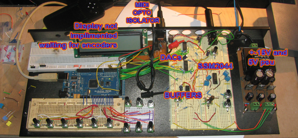

A little update.
now the wave outputs are on separate parralel DACS and it sounds much better!
i have to completely rejig the envelope system though. probably with more DACs, but serial ones, since they dont have to be quite as fast.
i built a nice little power supply which powers the +- 15v stuff
started tweaking the SSM2044 filter, no envelope control yet, but getting some squelchy synth sounds :), i love the 1977 IC filter with the 2009 arduino :)
when this is all how i like it i am going to make a single circuitboard for everything and put it in a case. ill keep the arduino in there so i can do USB updates for adding wavetables and changing the program.

newest development, controlling the voltage reference of the DACs with an envelope also generated on the same arduino basically its an 8 bit voltage VCA working on the level of the 8 bit DAC = 16 bits resolution
x2 for 2 of the DACS = lots of bits and very smooth sounding
also x1x2x3x4 etc sync its great to get deep purple type 5th organ
can play very high notes without any jitter.
octave semitone, and detune for second and third osc (3rd working but it has no envelope) control
mainly though the ADSR is much better now, before the control would basically jump from slow to fast, so i made another wavetable with exponential values and use it for the scaling of the controls, now i can get super nice ADSR, and also (soon) use the other wavetables for sections of the envelope.
also now the envelope PWM is running at 31.25 khz instead of 500hz so there is no zipper noise, it happens at the same speed as the wave is generated. can use a much smaller timebase filter and it is super snappy.
I intend for anything wavetable based to be able to use any of the wavetables even if they were not designed for it, for instance LFO using envelope of 5th harmonic wavetable, main osc using exponential control wave, decay using noise etc. might be good to bring back some of the glitchy digital sounds at extreme settings.
I am getting more and more real synth sounds even without the filter (problems with my filter i took it out, when the q was high the level really dropped) ill fix it later , im concentrating on the oscillators.
it started as a fun experiment, now it is really maturing to a usable synth. next up will be making it do glides 303 style.
ill put a new video of the oscillator this weekend. much better sound!

coming along very nice. i hope to make a arduino "shield" with the DACS and the filter, MIDI in and audio out.
although a non DSP micro controller like that is not really supposed to be a wave table oscillator it can be !
it does 3 now, besides what is in the video, now it has variable accent with its own AD envelope, it can tweak the filter, and also add a bit of osc 3 (which can be a seperate wavetable)
variable accent means, the accent does not happen at a fixed point like in a 303 or whatever, you can turn the knob and lower and lower velocities cause the accent to happen. its a great performance tool for baseline synths. also with different attacks i can get the "bwoow" drum and bass sound.
it would use MIDI in (i have started weaning it off its own internal controls) so you could build the dedicated controller or just use your sequencer or a MIDI controller to adjust the settings.
I am learning a lot of real world things about doing synthesis that will help me make the unimatrix zero really good.
